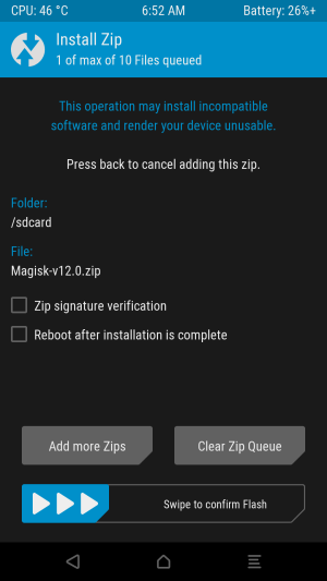

- FASTBOOT PROGRAMINI Kuralım ve DOSYALARINA twrp DOSYASINI ATALIM
- Minimal ADB and Fastboot PROGRAMINI ÇALIŞTIRALIM VE AŞAĞIDAKİ KODU YAPIŞTIRALIM
fastboot flash recovery recovery-TWRP-3.3.1-1118-XIAOMI_CC9PRO-CN-wzsx150.img
- TELEFONU RECOVERY MODA ALALIM VE WİPE KISMINDAN FORMATLAYLIM
- MAGİSK 19.4 RAR HALİNDE TELEFONA YÜKLEYELİM REDMi NOTE 10 PRO iMEi REPAiR
- İNSTALL BÖLÜMÜNDEN MAGİSK ‘İ KURALIM
- REBOOT SİSTEM DİYELİM VE TELEFON AÇILINCA WİFİ BAĞLAYALIM VE MAGİSK APK GÜNCELLEME MEVCUT İSE GÜNCELLEYELİM
- TELEFON ROOTLANMIŞTIR
